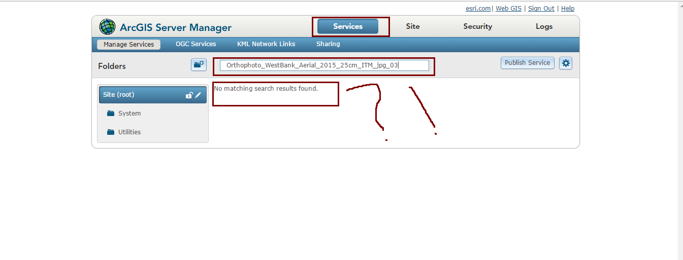

 Despite the fact that we delete the services from ArcGIS server, the Arcgis server logs still produce a query about these deleted services.
For example, I delete a service with the following name   “Orthophoto_WestBank_Aerial_2015_25cm_ITM_jpg_03”, if you search on this service you can’t find it in the services list as you can see below

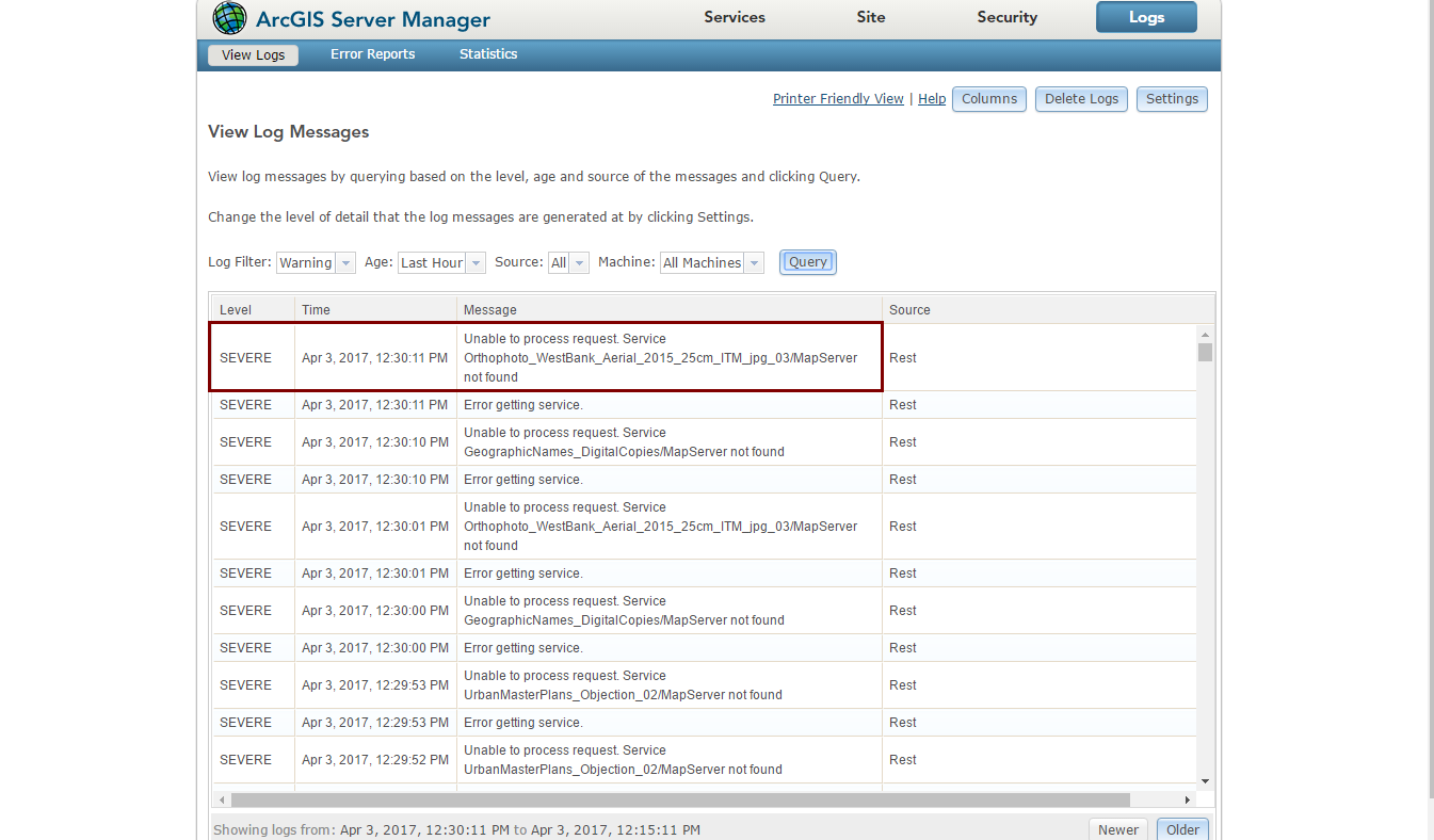

But the ArcGIS Server still reads the logs for this service
see the arcgis server logs below

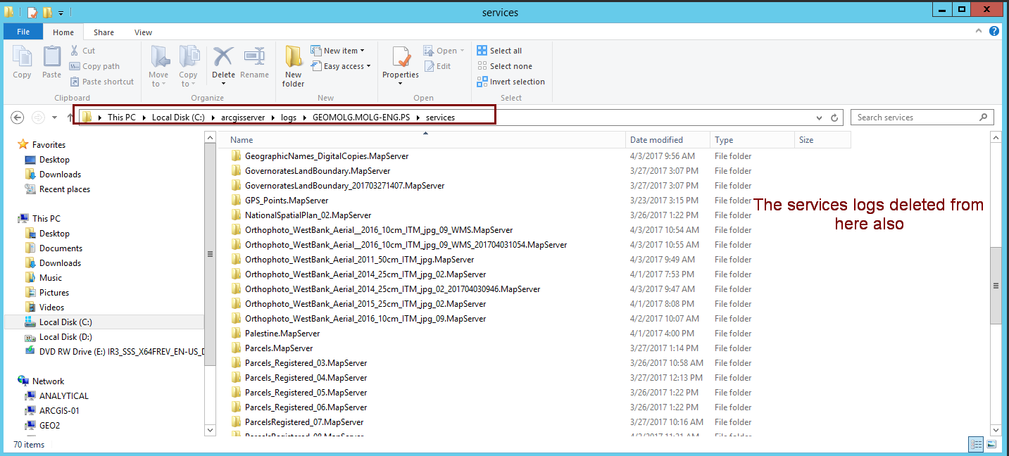

Also I tried to delete them from logs folder in the following path with no advantage.

That server log isn't based on the server environment still having an active service it is based on a user making a request. Despite having removed the service there could still be users that have the removed service stored into an MXD or Story Map (as examples, plenty more they could have it stored in). This means when they launch these items, requests are still made to your environment for the service that no longer exists.

Actually I walked through each folder, and cleaned up all folders related to this service.
As you can see from below screenshots if we search in the directories folder about that service, you will find nothing.

Scott is correct, this is expected (to an extent). Any client application that makes a request to a service that doesn't exist will cause this message to appear. This is logged as:
9503
Service ''{0}'' not found. Check if the service exists and is started.
That said, there's an issue (BUG-000090837) requesting to change this logging level from 'Severe' to 'Warning'.

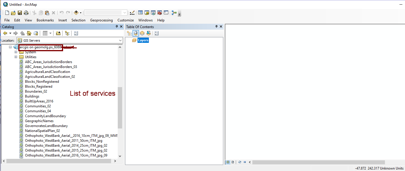

I tried this case on my local machine(private account), and when I delete the service and their logs and all connections, the ArcGIS server stop produce a query on that service. See below
i have a service "communities" published on LAB-11
i used this service on another machine (Lab-1)
then i delete the service
the logs still read that service
then i delete the connections & the logs
then there  are no more logs about this service
