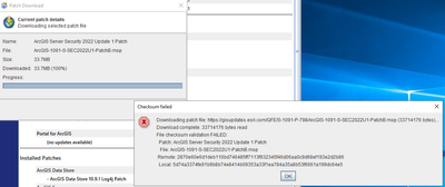

Trying to install the latest patch "ArcGIS Server Security 2022 Update 1 Patch" released on 1st of September,
I am getting the following error: "File checksum validation FAILED":
Was this patch not correctly published ?
Thanks !

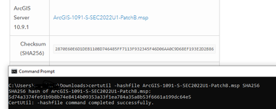

Same for the one online @George_Thompson :
NB: I am using 10.9.1

@NicolasGIS - can you try the download again?
I saw a post that the checksum was updated. Thanks!
--- George T.
ChristopherPawlyszyn
The mismatch should be resolved for all versions, please let us know if you're still having any trouble.
