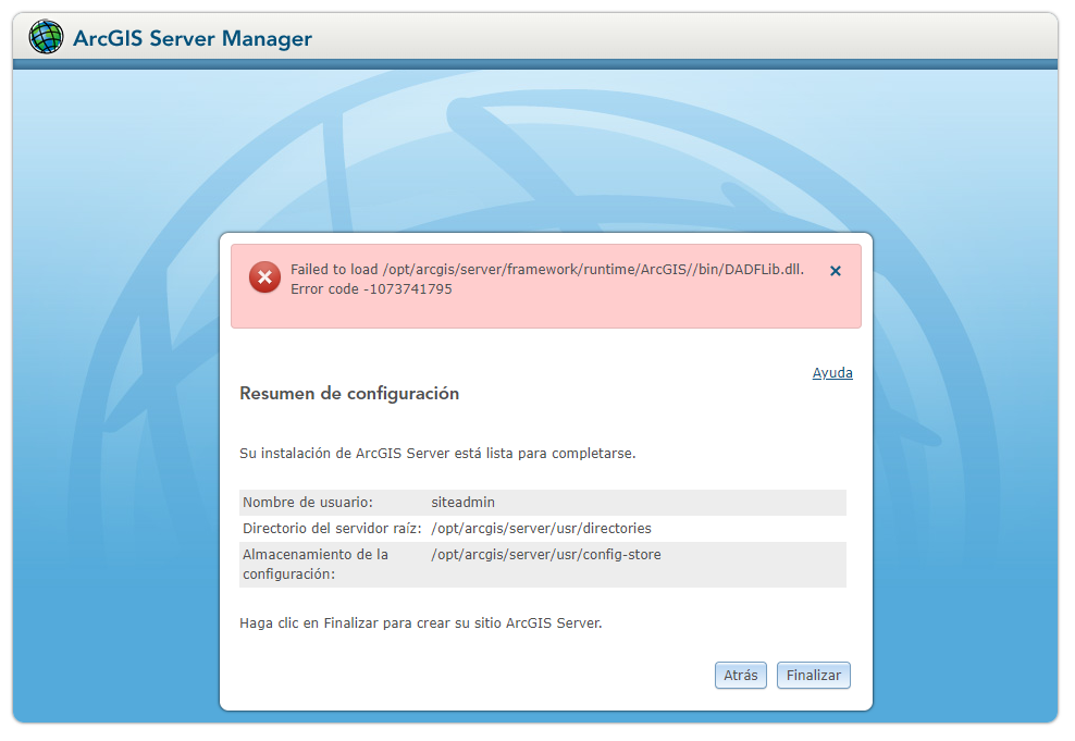

Hello,
An ArcGIS GIS Server 11.1 is being installed on a new server (no apps, just the ArcGIS Server). The error occurs when trying to create the initial ArcGIS Server administrator account.
Failed to load /opt/arcgis/server/framework/runtime/ArcGIS//bin/DADFLib.dll.
Error code -1073741795
I have searched for information online, but I don't see anything relevant.

I ran into a similar problem on ArcGIS Enterprise 11.0. After investigation, I found that my virtual machine did not recognize the avx instruction set by default. This problem was solved after enabling the avx instruction set on the virtual machine by modifying the vmx file of the virtual machine.
