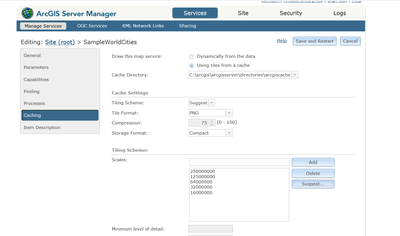

https://your_dns/webadaptor/manager/service.html?name=SampleWorldCities.MapServer
You can safely delete them out of the manager upgrade and then recreate them just note that re-creating them will take a few weeks I think for 57 terabytes.
I would just take screen shots of the services and then after the upgrade re-create the settings.
