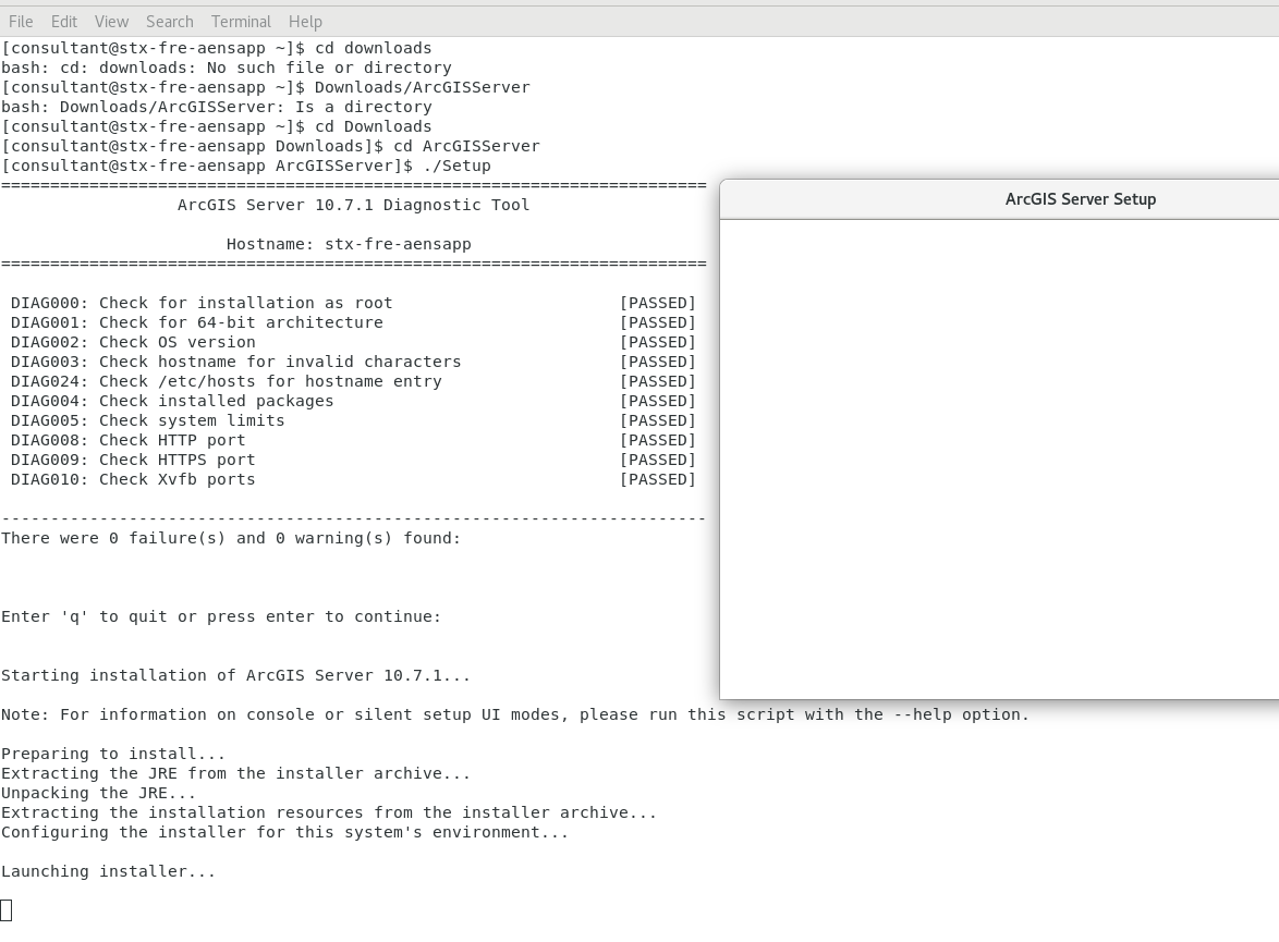

I am trying to install ArcGIS Server 10.7.1 son a Linux machine. I get no error message. I know I'm using the Linux installer and not Windows. I am using the command line to complete the installation.  It passes ALL the pre checks or requirements.  When it gets to the stage of the launcher it does not continue for me to click next.
Does anybody have any idea why this is happening?

Can I trouble you for information on what flavor of Linux this is being deployed to?
Also, do you know if you are installing with the GUI from the Desktop, or are you ssh'ed in with X11 forwarding?
