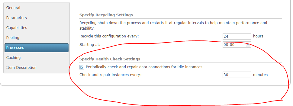

Hi everyone,
I was wondering about the option in the service properties about Health Check Settings that the ArcGIS Server checks and repairs data connections for idle instances.
It's described in the documentation here but it does not say what happens if a broken connection found and couldn't be repaired what would happen! Would it be just information in the logs? Would the service be stopped?
Anyone with experience to this option can enlighten me here 🙂 ?
John_Spence
The service continues to run, but you'll see missing table type errors in the logs.  The only caveat to that would be is if the table is missing and the service is turned off.  When you got to turn the service on, it will throw an error and not run.
ArcGIS Monitor to can help you with this and/or writing a custom script to pull the error logs looking for such an occurrence.  In my org, I control the DBs connected to the rest services.  Outside of my automated publishing processes, no one can accidently delete something which cuts down on issues like that.  Every once in a while there is an accident or someone doesn't update their service, but it is pretty easy to track down.
