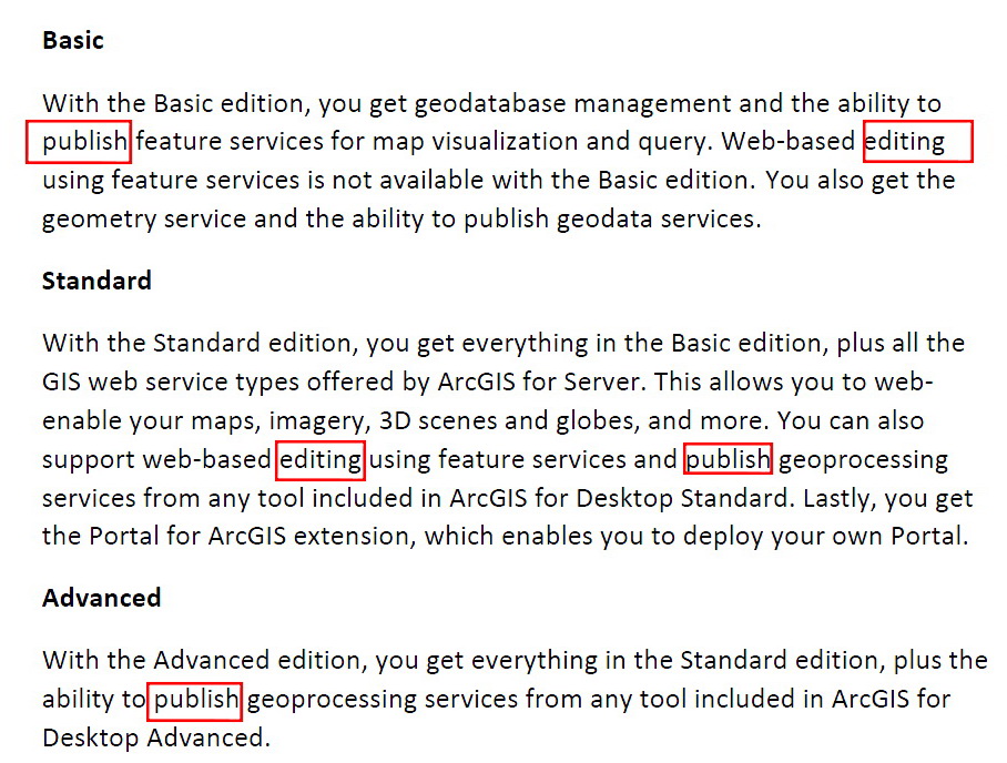

Thanks Domenico and Lieven,
At my workplace, we have ArcGIS standard\enterprise but I wanted to be more aware about the functionalities available in other license levels.
I thought that EDITING (enterprise geodatabase) and publishing FEATURE SERVICE (with edit property) is possible the ArcGIS Server Basic\Enterprise
By the way, it is not an easy job to be really aware about the functionalities of 9 combinations!

Just to clarify some of the comments in your 2nd post: the ArcGIS 10.3.1 for Server functionality matrix does document information on what ArcGIS Server Basic can do.
The screen shots you took of the functionality matrix are from page 3, but at the end of the table (on page 4) there is a note that says: "For more information about each category, see the Functionality Matrix Details section of this document." This section begins about mid-way on page 7.
More detailed info each web service type is summarized in a table at the top of page 10, and this is where we've noted that ArcGIS Server Basic only supports read-only feature services.
FYI, more detailed information on the supported database platforms are covered in the Support for Spatially Enabled Databases section starting at the bottom of page 15.

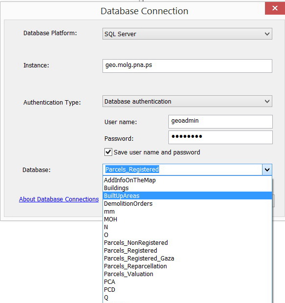

Many thanks Lieven, Domenico, and Derek.
I’m not sure if I correctly understood the trick.
1. Can the ArcGIS Basic\Enterprise still PUBLISH enterprise geodatabase feature class but the “feature access” property can’t be checked?
2.Is the ArcGIS Desktop Basic able to CONNECT to enterprise geodatabase feature class (ArcGIS Basic\Enterprise is available)
3. Is the ArcGIS Desktop Basic able to EDIT enterprise geodatabase feature class (ArcGIS Basic\Enterprise)

LievenDE_ROO
Deactivated User
1.No you can't . you would receive the high warning "the layer's data source is not supported (feature service)" when publishing with feature access. You have no means to create an enterprise database with a basic license. But in theory you can publish with basic server only with "query feature acces"
2. I checked it. And i can connect with a database i previously made with an advanced license. I can't edit however.
3. No

JamalNUMAN
Legendary Contributor
Thanks Lieven,
#1: In the Matrix guide, it stays that one can publish feature access service but editing will never be possible. At the end: can the ArcGIS Server basic\enterprise Publish feature service or not?
#4: How many levels of licensing do we have for ArcGIS Server? Are they 6 or 9?
