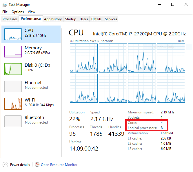

Many computers today have a hyper-threaded CPU which show more number of logical processors than cores. See image below.
On such machines, is ArcGIS Server licensing and performance to consider this as a 4 core or a 8 core machine?
For licensing - should I purchase two licenses?
For performance - can I configure 16 or 32* map service instances?

A per-core-license is for the physical core and not for the logical.
Attention: in a virtualized environment the license would be on vCPU's - whatever there is behind that number.
HyperThreading does not double the performance of your machine. In best cases there is a little gain ( 15%-30% ). For more infos see: Will Hyper-Threading Improve Processing Performance
If ArcGIS Server can really benefit from HyperThreading is a good question. In my opinion ArcGIS Server can be single-threaded (high isolation) or multi-threaded (low isolation) (see: Process threads). If I'm getting this right, I suppose: to take advantage of HyperThreading you should use low isolation (on a physical machine).

Hi Vince,
I don’t feel that the question is answered.
If the machine has 6 cores and 12 logical processors, how this is considered for ArcGIS Server? Does the ArcGIS Server work based on the cores or logical processors?

So here's what the the documentation says (my emphasis):
The ArcGIS Server component of ArcGIS Enterprise is licensed by CPU cores. Cores are part of the computer’s CPU (Central Processing Unit) that determines the number of instructions that can be processed at a given time. A 4-core processor can handle four sets of instructions at once. Many modern CPUs further support a technology known as hyper-threading that allows a single core to run multiple concurrent sets of instructions. Hyper-threads do not count towards the licensed cores. Licensed cores can be counted by physical cores or virtual cores, whichever is more advantageous to you. The minimum purchase for ArcGIS Enterprise is an “up-to-4 core” license* which can be installed on a two or four core machine. If your machine has more than 4 cores (physical or virtual), you can purchase additional cores, or virtualize the machine so that the 4-core license of ArcGIS Enterprise is only installed on 4 (virtual) cores and thereby satisfies the license requirement. If a 4-core license is installed on an 8-core physical machine without virtualization, then ArcGIS Enterprise will use all 8 cores and would be in violation of the license agreement until you purchase a license for the four “additional cores”.
And further:
Note that early generations of Microsoft Azure VMs used physical core equivalents, listed in terms of “cores”, whereas later generation Microsoft Azure VMs use vCPUs that correspond to a hyper-thread. It is important to calculate the physical core equivalent correctly based on the specific generation of VM that is chosen.
*Note: ArcGIS Enterprise requires a minimum initial license purchase of 4 cores per physical location. The minimum for ArcGIS Enterprise Workgroup is 2 cores. Additional cores may be licensed in 2-core increments. ArcGIS Enterprise Workgroup is not licensed for multi-machine environments
If you find this unclear, you should contact Customer Service, Tech Support, or your local marketing representative.
