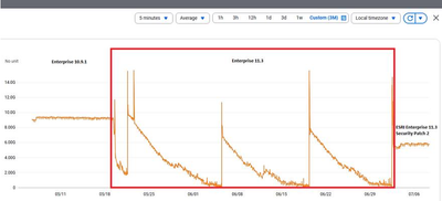

@JoshuaBixby @bernsk If it helps at all... we experienced memory leaks after upgrading to 11.3 which was only resolved after the Security Patch 2 B. Our Available Memory also dropped from 10gb to 6gb. Interestingly, when we did have the memory leak our RAM would start higher at ~8gb before dropping by ~500mb-1gb/day. With the Security Patch we start on 6gb...

Very interesting results, thanks for sharing.  I will have to revisit the issues fixed in that security patch to see what may have been the defect causing the memory issues.
RiceAdam
I cannot find any mention of a known Memory Leak when upgrading versions (or introduced in Security Patch 1); nor a fix in the Security Patch 2 B documentation, but it was/is occurring across multiple envs. I've raised this with ESRI.
