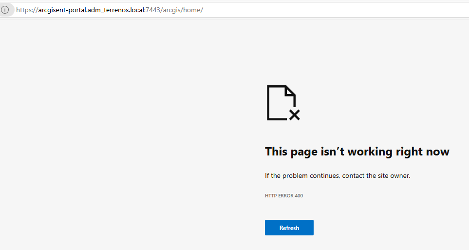

Hello,
I am doing a deployment for ArcGIS Enterprise 11.3 on windows server2022 VM  on premise but i am having issues with arcgis server and portal for arcgis processes. I used a domain user to execute portal, server and datastore services but, for example, for portal just tree are the ones that runs.
 and obviously, portal page don't show

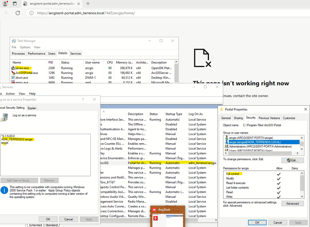

Hello,  I checked permissions on C:\program files\arcgis\portal folder and E:\arcgisportal folder, and both has full control for arcgis user. Also, user is in log on as a service, space in C:\ 80GB free and E:\ 140GB free
i tried to install 10.9.1 version, instead 11.3 and I got the same error with arcgis portal and arcgis server. arcgis domain user was set as administrator, i used a domain user and a local user and i have had the same result for both, portal and server

EdwinRoa
Using URL https://localhost:7443/arcgis/home. Is it produce the same result?
You need to check if domain (arcgisent-portaladm_terrenos.local) respond.
By including the domain in host file you can test it.
# 127.0.0.1 localhost
to
 127.0.0.1 arcgisent-portaladm_terrenos.local
DiegoLlamasOlivares
Hello,
No, it did not work changing localhost in host file. also, when i use https://localhost:7443 it redirects me automatically to https://arcgisent-portal.adm_terrenos.local:7443/arcgis/home. I also run the portal installer right click, run as administrator.
