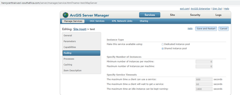

to implement case 2
Go to ArcGIS Server Manager Site Settings and apply the settings as below
Then go to all ArcGIS Pro Services and apply these settings
Hope it helps
