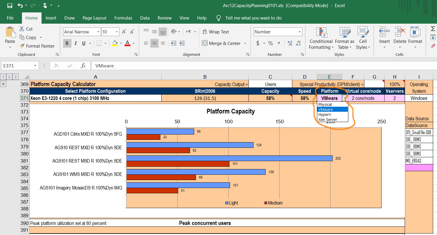

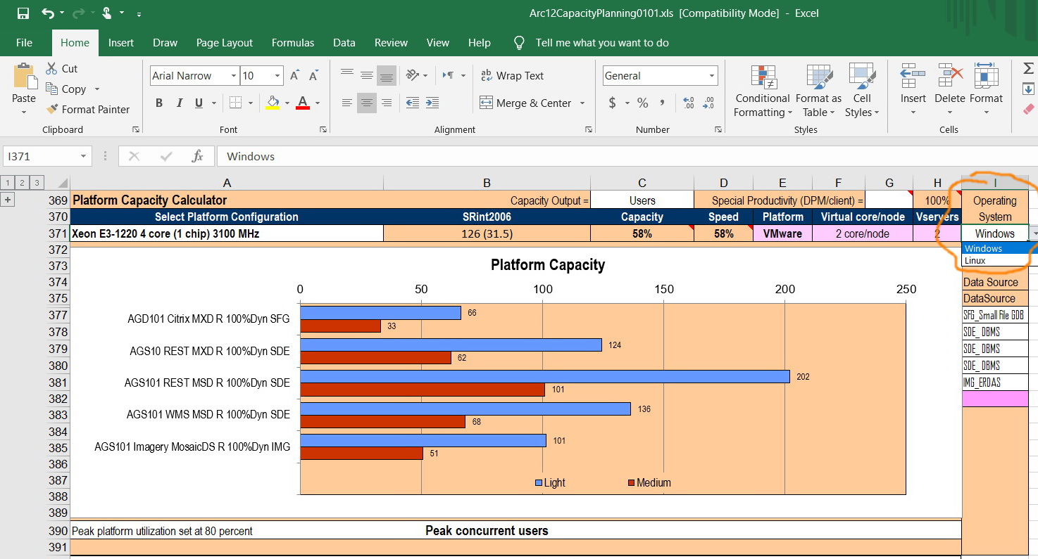

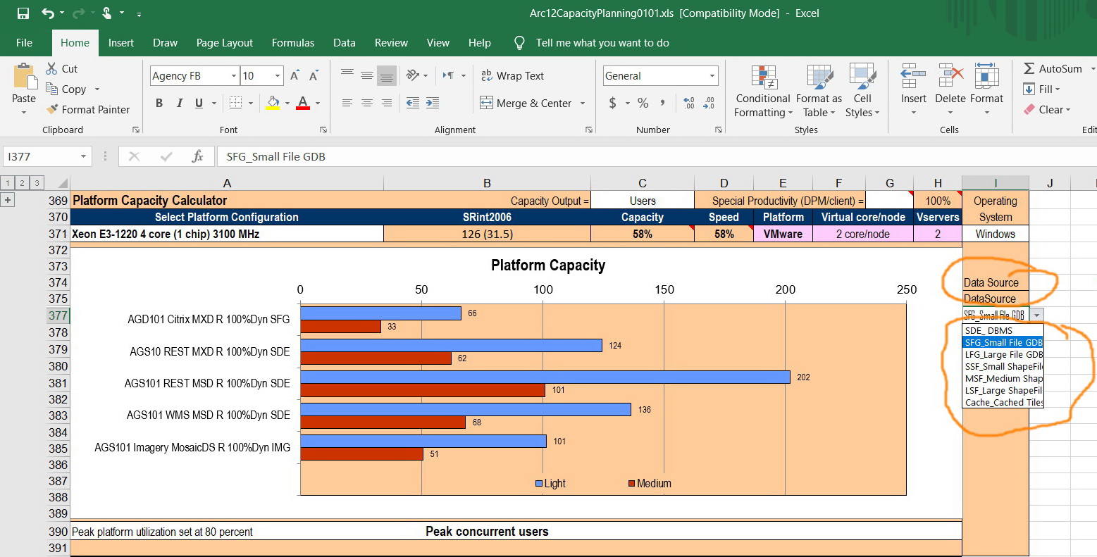

The Platform Capacity Calculator confirms that the number of concurrent users depends on CPU, data (mdf, gdb, shp, etc.), ArcGIS Server services (mxd, ,msd, wms, mosaic), operating system (winows, linux, ect.), and platform (physical, VM, etc.),

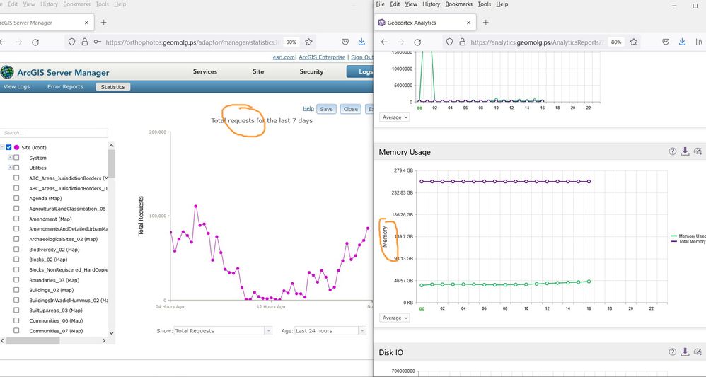

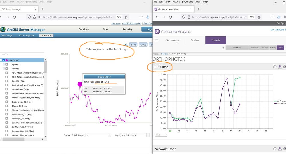

I am using the CP analysis tool for estimating the HW specs for a new ArcGIS Enterprise deployment, and I wonder if you can guide me on how I can find the calculated RAM utilization for the architecture platforms used in the analysis.

Hi Ihab,
Unfortunately, there is no direct relation between the load (number of requests) and the resources (Cores\RAM) which makes it a bit challenging to find a good match between them (load and resources).
Best
Jamal
