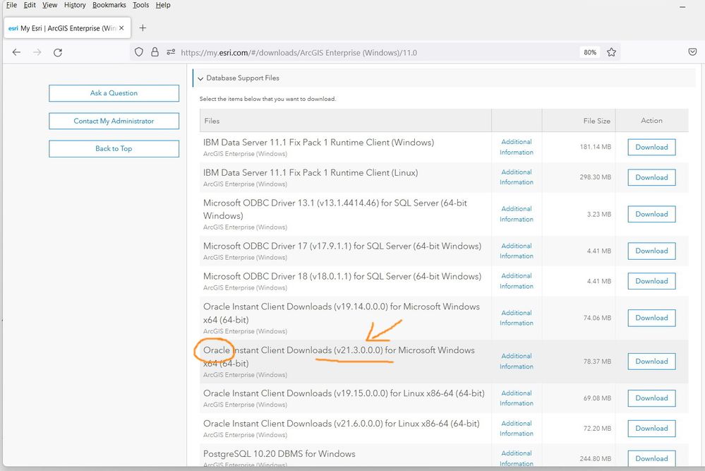

In myesri site, I observed that the Oracle 21.3 is already available.

Ok, I can understand that. But in the supported DBMS's for Oracle we do not list it: https://enterprise.arcgis.com/en/system-requirements/latest/windows/database-requirements-oracle.htm
My guess would be that we are providing the Instant Client since it is available to the public and backwards compatible. I do not have any insight into if and / or when Oracle 21c may (or may not) be supported.
Being that 21c is an Innovation Release it's life does not seem to be that long; https://support.oracle.com/knowledge/Oracle%20Database%20Products/742060_1.html
