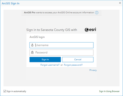

Hello - we suddenly as of today cannot sign into our just-upgraded portal 10.9.1 from Pro 2.9.  A Fiddler session indicates a favicon.ico can't load, and then we don't get the login boxes:
ArcGIS Onilne:
Anyone else seeing this?

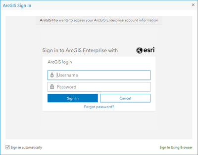

Well, the login dialog window from Pro 2.9 reappeared with username password form:
for reasons unknown.  But I can say it had nothing to do with the favicon.ico not loading.
