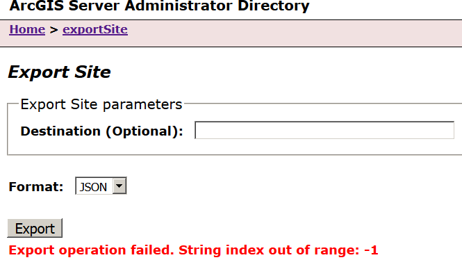

The same error is generated when we try to use the exportSite tool in Server admin:

After several months of testing and trying to figure out the problem Esri Support finally  got the source of the problem.
"We were able to test the whole configuration you have and have determined the issue to be with your existing services and the FolderInfo.json file stored in the folder containing the service. If either one of the two are deleted the export site function works correctly. This causes us to believe that there is an issue with them existing together.
However, if we publish a new service to ArcGIS Server, using an mxd of the existing service, the export site function works fine. Would it be possible for the user to republish his services so as to regenerate all the FolderInfo.json files and then attempt to backup the site?
The FolderInfo.json file they are referring is the file in /config-store/services/<folder containing the service>
The file contains one line of code, information about the folder name and a few more information.
{"folderName":"yourFolderName","description":"None","webEncrypted":false,"isDefault":false}
Deleting the FolderInfo.json would make the folder containing the services invisible in ArcGIS manager or any client interface. The worst thing is, the Webgisdr Backup tool completes successfully, but it will exclude the services in the hidden folders. Basically there will be no content in the backup.
The only way going forward was to republish all the services and generate a new FolderInfo.json.
Weird though, this small file will cause such inconvenience in ArcGIS Enterprise.
