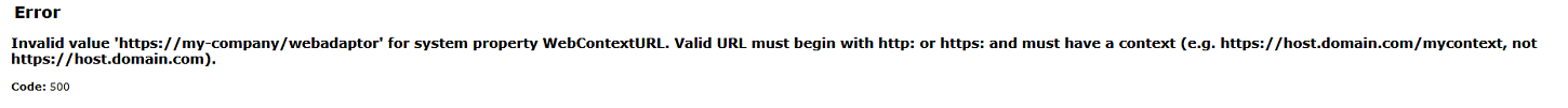

I have been attempting to set a Web Context URL for our Enterprise Setup after our Reverse Proxy has came up. When attempting to set this URL, I get this error here:

Why could this be incorrect? It fits what the error message is requesting and context is set, it does not matter what I put in for the context, it will still error. Anyone have similar issues?

I believe the issue is that the WebContextURL parameter is expecting a traditional DNS entry (https://gis.example.com) and by only passing the server name in (https://gis) it's not meeting the requirements. You would need to configure your server to use an FQDN to be able to set that property.

Hey Reese,
My example did not highlight my actual URL as correctly as it should have, I am currently using a traditional DNS entry, it's more like https://arcgis-notebook.company.com which is the FQDN for this case.
