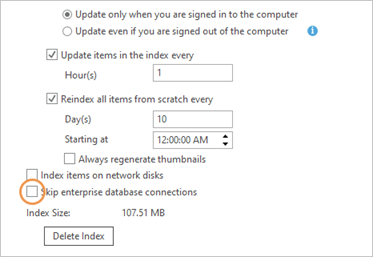

The contents of enterprise geodatabases aren't indexed by default in ArcGIS Pro. To enable indexing, go to the Settings page (click Project tab in a project), click Options on the left, and click the Indexing option. In the Options dialog box, uncheck the box that says Skip enterprise database connections. Same thing for network folders--except you have to check the box to index them. Index project items

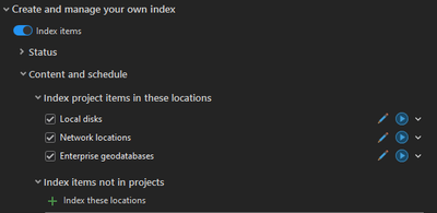

My options look a bit different than that.
