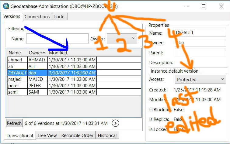

Asrujit_SenGupta
MVP Alum
Last edited\modified Version can be checked from the 'Geodatabase Administrator' window, under the "Modified" tab:

MajdoleenO_A__Awadallah
Dear Asrujit SenGupta ,
Sorry for the late reply, I think you suggestion will not work as we expected! I tried this example:
Suppose that the last edited version is Majd, but he edited two points at different time, Point number 3, then version Ali edited points number 3 and number 5, after that, Majd edited point number 5. So the last version who edit point number 3 is Ali, and point number 5 is Majd, so if I applied your suggestion (applying the reconcile tool to the last edited version-Majd), in this case the change on point 3 will be affected by Majd version and not by Ali. Do you agree with me?
