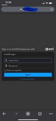

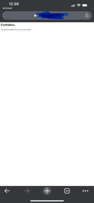

Hey there We’ve just got our arcgis enterprise 10.9.1 installed on a windows server 2019 working with a puplic ip linked to CloudFlare cdn and a firewall inside the network I set it up and configured the domain name and when i login to portal from outside the network it’s response as follow: (You don't have permission to access this resource.) and i can login from the arc gis apps like Collector and the other apps and i can even login to portal admin and server manager and server admin but when trying to login to portal  it’s redirected my request to this link https://mydomain/portal/sharing/oauth2/signin and here where is the error message come .

Thank you very much I’ll do that i can reach every thing except the portal link  when i enter the username and password and click login error 404 (You don't have permission to access this resource.) shown it’s look like an a authorization proplem the wired thing i can login from Survey 123 app and the others phone apps on my phone with the same account but only on the portal it’s happening!
