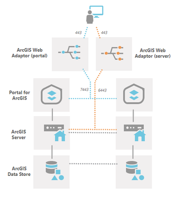

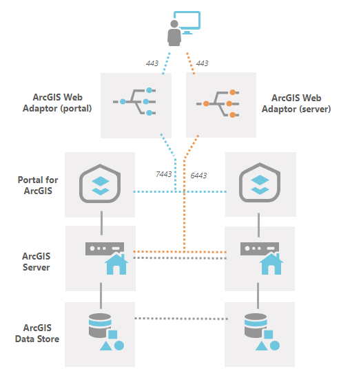

We have two machines in this environment and we installed all 4 components (portal, server, datastore, and web adaptors for portal and server) on each. We installed and created sites on the first machine, and we joined the portal and server components to existing sites from the first machine. The server and portal are federated and everything seems to work perfectly. We also updated our WebContext URL appropriately. However, we are having issues whenever we attempt to publish data from Enterprise Geodatabase. The database we are using is Oracle. We have also attempted to register a Microsoft SQL Server database, and still experienced the same issue.

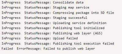

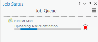

For the failed sharing from Enterprise Geodatabase, the publishing job gets stuck on "Uploading service definition" for longer than usual before failing as shown below:
The log below was also generated from each failed attempt:
Map1		8	WebMapImageLayer	ArcGIS Enterprise	https://webserver.hostname.tld/server	portaladmin	2023-12-12 09:35:41	Status: InProgress	StatusMessage: Successfully wrote sharing info file
Map1		8	WebMapImageLayer	ArcGIS Enterprise	https://webserver.hostname.tld/server	portaladmin	2023-12-12 09:35:41	Status: InProgress	StatusMessage: Successfully wrote sharing connection file (Number of SDE Connections: 1)
Map1		8	WebMapImageLayer	ArcGIS Enterprise	https://webserver.hostname.tld/server	portaladmin	2023-12-12 09:35:41	Status: InProgress	StatusMessage: Loading manifest
Map1		8	WebMapImageLayer	ArcGIS Enterprise	https://webserver.hostname.tld/server	portaladmin	2023-12-12 09:35:41	Status: InProgress	StatusMessage: Creating thumbnail from map
Map1		8	WebMapImageLayer	ArcGIS Enterprise	https://webserver.hostname.tld/server	portaladmin	2023-12-12 09:35:41	Status: Pending	StatusMessage: Sharing process started
Map1		8	WebMapImageLayer	ArcGIS Enterprise	https://webserver.hostname.tld/server	portaladmin	2023-12-12 09:35:42	Status: InProgress	StatusMessage: Sharing process started
Map1		8	WebMapImageLayer	ArcGIS Enterprise	https://webserver.hostname.tld/server	portaladmin	2023-12-12 09:35:42	Status: InProgress	StatusMessage: Loading manifest
Map1		8	WebMapImageLayer	ArcGIS Enterprise	https://webserver.hostname.tld/server	portaladmin	2023-12-12 09:35:42	Status: InProgress	StatusMessage: Reading thumbnail from file
Map1		8	WebMapImageLayer	ArcGIS Enterprise	https://webserver.hostname.tld/server	portaladmin	2023-12-12 09:35:43	Status: InProgress	StatusMessage: Publishing process started
Map1		8	WebMapImageLayer	ArcGIS Enterprise	https://webserver.hostname.tld/server	portaladmin	2023-12-12 09:35:43	Status: InProgress	StatusMessage: Preparing data references and staging web layer
Map1		8	WebMapImageLayer	ArcGIS Enterprise	https://webserver.hostname.tld/server	portaladmin	2023-12-12 09:35:43	Status: InProgress	StatusMessage: Loaded SDE Workspaces
Map1		8	WebMapImageLayer	ArcGIS Enterprise	https://webserver.hostname.tld/server	portaladmin	2023-12-12 09:36:06	Status: InProgress	StatusMessage: Using ArcGIS Version 13.1 for staging (Source for version: GP Staging Parameters)
Map1		8	WebMapImageLayer	ArcGIS Enterprise	https://webserver.hostname.tld/server	portaladmin	2023-12-12 09:36:06	Status: InProgress	StatusMessage: Stage Tool initialized
Map1		8	WebMapImageLayer	ArcGIS Enterprise	https://webserver.hostname.tld/server	portaladmin	2023-12-12 09:36:06	Status: InProgress	StatusMessage: Preparing maps and layers for processing
Map1		8	WebMapImageLayer	ArcGIS Enterprise	https://webserver.hostname.tld/server	portaladmin	2023-12-12 09:36:09	Status: InProgress	StatusMessage: Retrieving and processing fonts
Map1		8	WebMapImageLayer	ArcGIS Enterprise	https://webserver.hostname.tld/server	portaladmin	2023-12-12 09:36:10	Status: InProgress	StatusMessage: Executing...
Map1		8	WebMapImageLayer	ArcGIS Enterprise	https://webserver.hostname.tld/server	portaladmin	2023-12-12 09:36:10	Status: InProgress	StatusMessage: Start Time: Tuesday, December 12, 2023 9:36:09 AM
Map1		8	WebMapImageLayer	ArcGIS Enterprise	https://webserver.hostname.tld/server	portaladmin	2023-12-12 09:36:10	Status: InProgress	StatusMessage: Succeeded at Tuesday, December 12, 2023 9:36:09 AM (Elapsed Time: 0.03 seconds)
Map1		8	WebMapImageLayer	ArcGIS Enterprise	https://webserver.hostname.tld/server	portaladmin	2023-12-12 09:36:13	Status: InProgress	StatusMessage: Consolidate data
Map1		8	WebMapImageLayer	ArcGIS Enterprise	https://webserver.hostname.tld/server	portaladmin	2023-12-12 09:36:13	Status: InProgress	StatusMessage: Staging map service
Map1		8	WebMapImageLayer	ArcGIS Enterprise	https://webserver.hostname.tld/server	portaladmin	2023-12-12 09:36:35	Status: InProgress	StatusMessage: Compressing package into SD file
Map1		8	WebMapImageLayer	ArcGIS Enterprise	https://webserver.hostname.tld/server	portaladmin	2023-12-12 09:36:37	Status: InProgress	StatusMessage: Staging successful
Map1		8	WebMapImageLayer	ArcGIS Enterprise	https://webserver.hostname.tld/server	portaladmin	2023-12-12 09:36:37	Status: InProgress	StatusMessage: Uploading service definition
Map1		8	WebMapImageLayer	ArcGIS Enterprise	https://webserver.hostname.tld/server	portaladmin	2023-12-12 09:36:38	Status: InProgress	StatusMessage: Publishing tool initialized
Map1		8	WebMapImageLayer	ArcGIS Enterprise	https://webserver.hostname.tld/server	portaladmin	2023-12-12 09:36:38	Status: InProgress	StatusMessage: Publishing web layer (AGS)
Map1		8	WebMapImageLayer	ArcGIS Enterprise	https://webserver.hostname.tld/server	portaladmin	2023-12-12 10:07:41	Status: InProgress	StatusMessage: Upload failed
Map1		8	WebMapImageLayer	ArcGIS Enterprise	https://webserver.hostname.tld/server	portaladmin	2023-12-12 10:07:43	Status: InProgress	StatusMessage: Publishing tool execution failed
Map1		8	WebMapImageLayer	ArcGIS Enterprise	https://webserver.hostname.tld/server	portaladmin	2023-12-12 10:07:45	Status: Failed	ErrorMessage: Failed to publish web layer

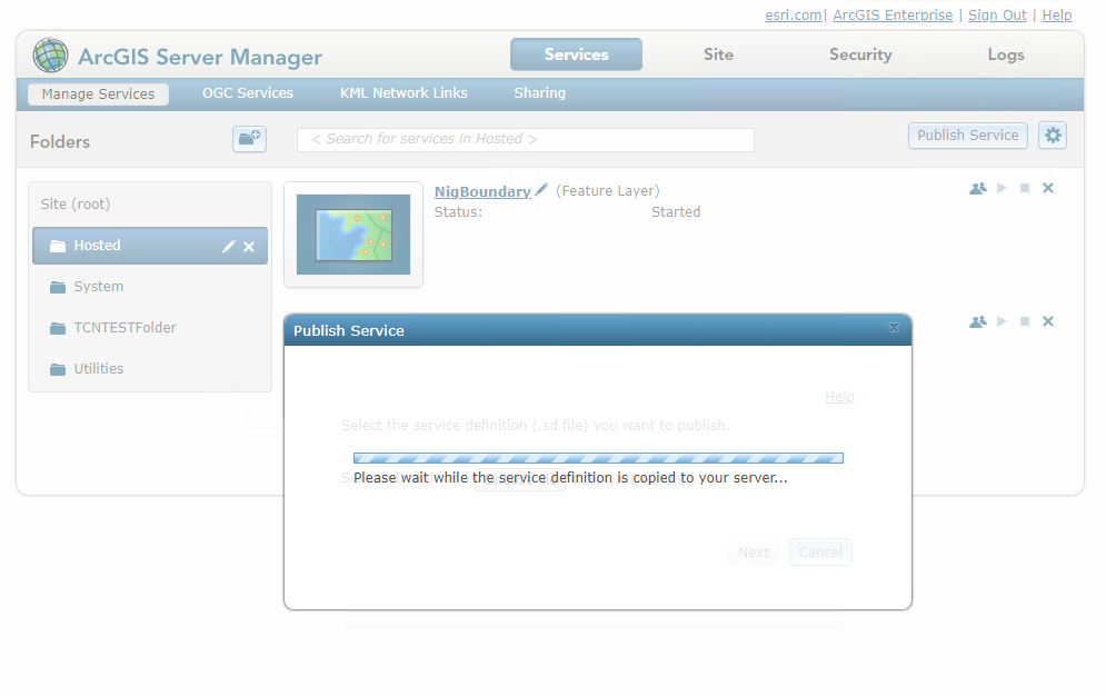

I used FAILED/INCONCLUSIVE for the 6th test, because the service definition upload on Server Manager keeps uploading for hours with no fail/success result.
