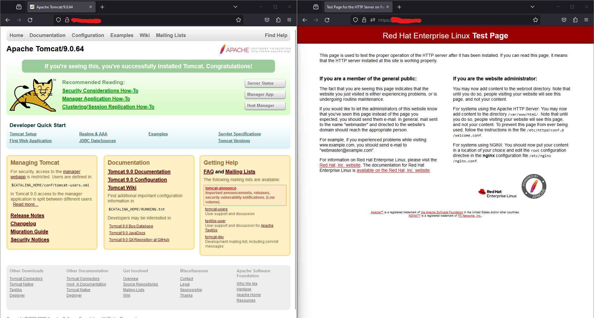

Recently we discovered the web adaptors no longer work on machine A, no idea how it happened, the infrastructure team said they didn't do anything on the machine. After several troubleshooting, we discovered that the Apache Tomcat service has not been running. So we did some tweaks, and Tomcat is running. Then we notice that Tomcat landing page is only displayed when the protocol is HTTP. Once we put HTTPS in the browser, the webpage displayed is the Red Hat Enterprise Linux Test Page. This is where we are currently stuck. It was working before, but it no longer works. We've adjusted the connectors in the server.xml file to no avail. Calling on anyone here who can help resolve this issue because User acceptability session has been scheduled for next week. We need to have the deployment running this weekend.
In the screenshot below, the page on the left is displayed wihen we use http://,  the one on the right is when we use https://

I suspect you have a port conflict where Apache httpd and Tomcat are both trying to listen on port 443.  That's why you are seeing the RHEL Test Page.  If you are not using the Apache httpd, the easiest fix is to disable that and only run Tomcat.  If you are hosting other apps on Apache httpd, it might be easier to configure Apache as a reverse proxy for Enterprise and not use Tomcat.  Documentation on configuring the reverse proxy can be found here:

Thanks @JeffSmith you're right, there was really a conflict. We disabled the httpd service and the tomcat server is working fine now.
