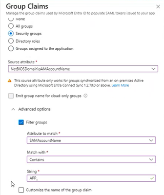

I struggled recently when migrating my Enterprise  from ADFS SAML to Entra ID SAML and came across this when searching for a solution. After many tries I found the solution and I'd like to share it here
reconfigure the Group claims like this:
My ADFS communicates the groups in a DOMAIN\Groupname naming format and by choosing Netbiosdomain\sAMAcountName, you get the same format and your existing portal groups continue to work. And it looks like @LaurePillet2 was searching for this specific setting as well to get to the group names instead of the identifier
I filter the groups, because Entra is limited to 150 groups in the claims and if you exceed this number you don't get any. It's more likely to work on ADFS without filter because ADFS only knows your AD claims, but with EntraId, I get Entra claims in addition from the claims from AD and it exceeded 150 in my case. All my GIS groups have APP_ in the name, so using this filter brings down the number of claims well below 150 in my case.
Import the federation metadata.xml from the EntraID URL when reconfiguring. manually changing the urls from ADFS to Entra on the existing SAML login works, but Entra has a different XML namespace for the group claims and you cannot reconfigure this, and reading the xml federation again from the URL fixes this.
-Joël Hempenius.
