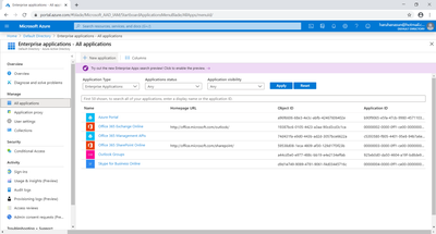

  1. Select the Azure Active Directory item and then click Enterprise Applications from the Azure Active Directory left-hand navigation menu.
  1. Click New Application on the Enterprise Applications pane.

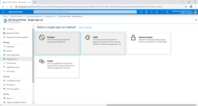

  1. Once the application loads, click the Set up single sing on tab and then select SAML

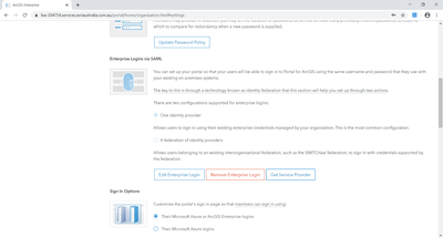

  1. Login into your ArcGIS portal with admin, go to Organization - Settings - Security, click Get Service Provider and then save Metadata.xml file

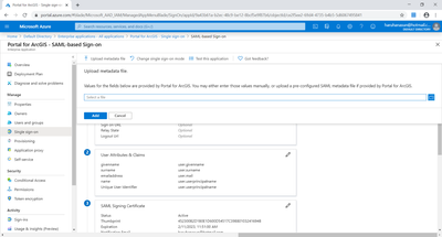

  1. Back to the Azure Portal page, click 'Upload Metadata file' at the top of the banner, and then upload your Metadata.xml
  1. Go to SAML Signing Certificate, download 'Federation Metadata Xml'.
  1. Go to ArcGIS port Portal, Organization - Settings - Security, click Enterprise Logins visa SAML, upload your Azure metadata to portal and save changes.

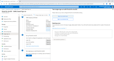

  2. Go to Azure Portal, you now should be able to Test your configurations.
  1. Log off from your Portal and then click Enterprise login with your AD account. LiranSun_9-1615265841207.png
