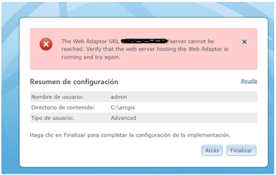

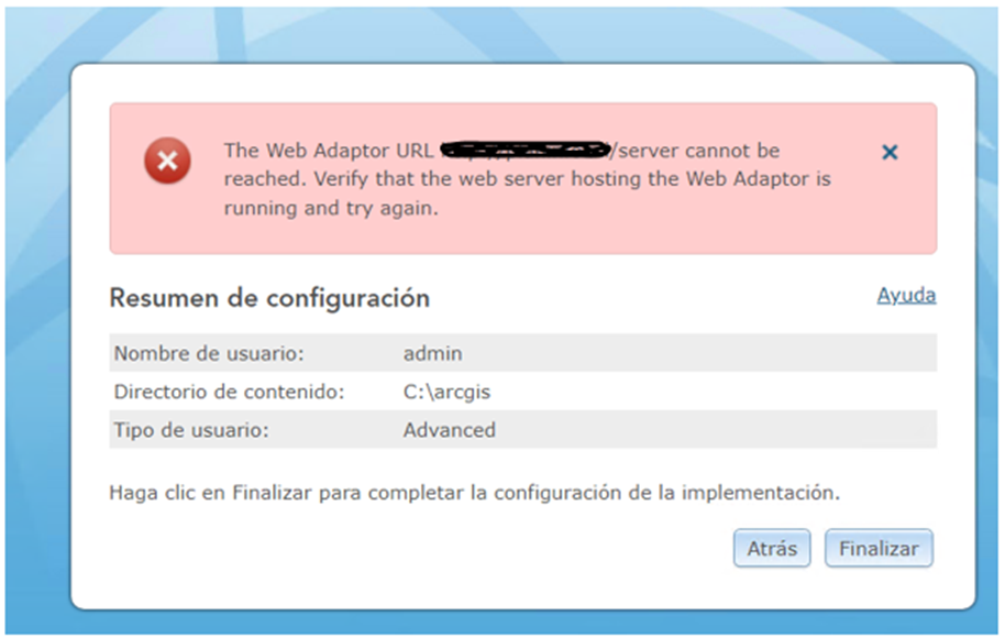

I follow the next and next steps, I get to finish and…. process stops at step
1) environment validation.
Creator or advanced user type, this is the third time that I do everything from scratch, and in no previous step did it ask me to configure the webadaptor again, unless even though Arcgis Builder was uninstalled, continue anyway the webadaptor installed on the system... check the panel control and everything was uninstalled.
What should I do? =(

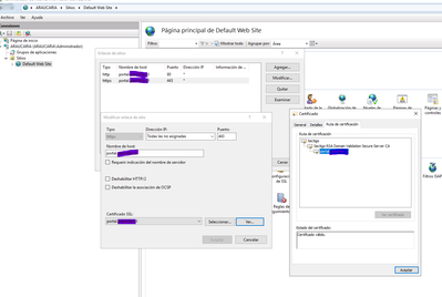

Try deleting the hostname in the HTTPS binding (see below).  Leave the hostname blank:

Hi @PlaninforAdmin,
If you go to IIS Manager>Machine Name>Sites>Default Web Site>Bindings, is there a hostname set there?  If so, try deleting this and see if the configuration wizard will let you proceed.

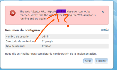

PlaninforAdmin
I have only the host server certificate installed, it only allowed to remove the https, but the problem persists.
In addition, the error that is showing me is from the webadaptor that I used in the previous installation. Now I bought a portal.miweb.cl subdomain certificate but the error continues to show me the previous webadaptor, even though I previously uninstalled it.

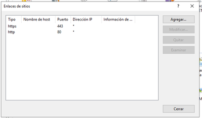

PlaninforAdmin
You do not know how much I appreciate it, it has worked for me! 😃
I am left wondering if I should re-enter these host values later or just leave them like that?
JakeSkinner
Esri Esteemed Contributor
Leave them blank.
