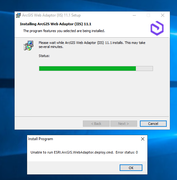

When installing ArcGIS Web Adaptor (IIS) 11.1 the installer fails at around 75% with the following error:
Web site (Port):
Default Web Site (443)
Name of ArcGIS Web Adaptor
portal

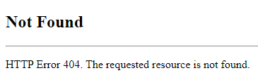

When I press OK the installation completes. The browser opens with a
I did uninstall the adaptor from the server and did a fresh downloaded of the adaptor installer from the ESRI website but I am still running into the same problem.
Has anyone come across this error?
