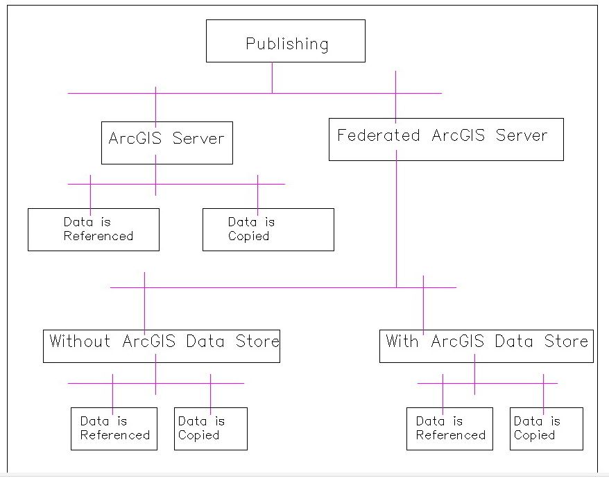

I figured out to plot the flow chart in the screenshot below trying to learn the advantage of an option over the other.
Does this mean that the difference between the “ArcGIS Data Store” over the regular “Data Store” is just where the physical data is stored when publishing with “Copy” option?

Where the data is stored is the physical difference but it is not the way you compare them.
