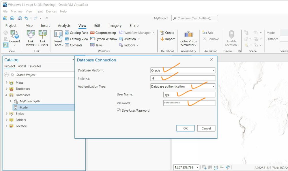

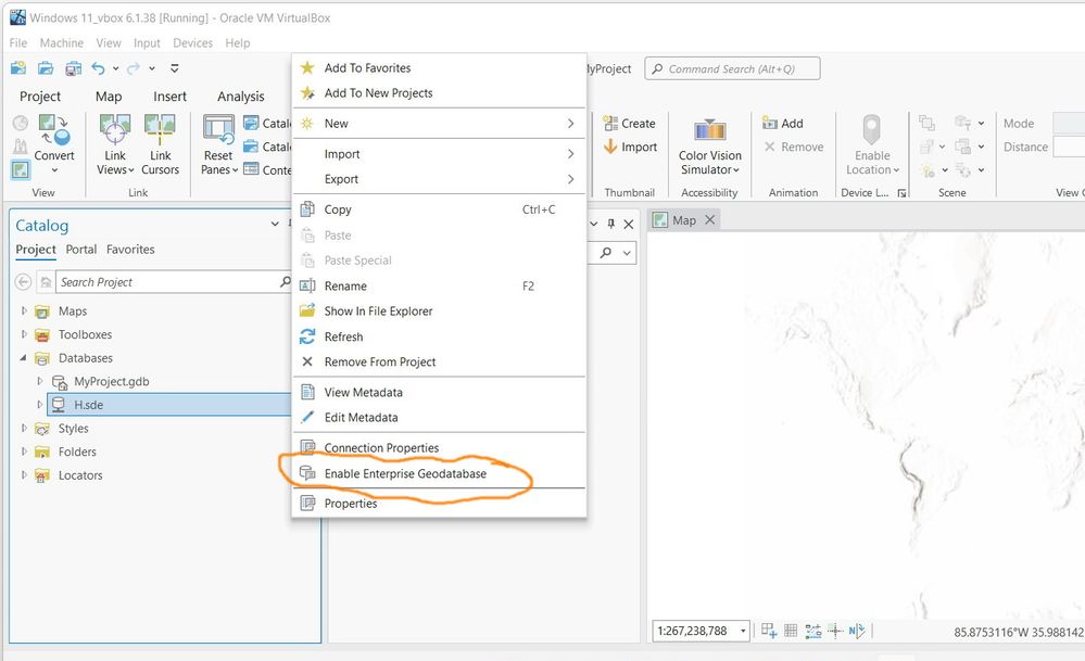

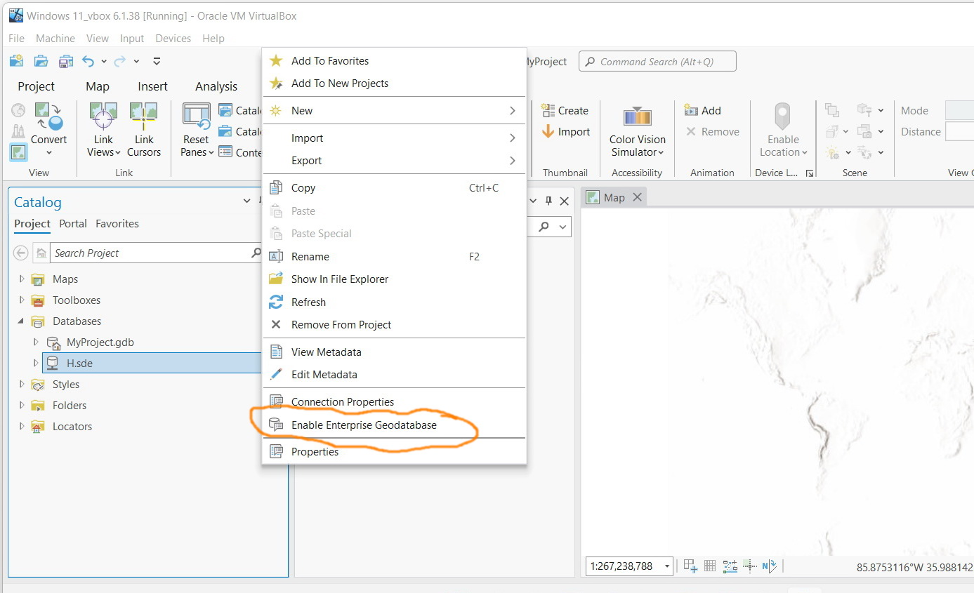

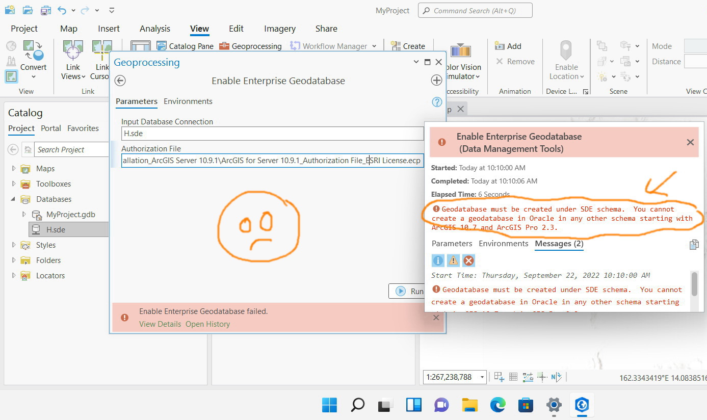

I couldn’t figure out why enabling Oracle 19.3 database fails and ends up with “Geodatabase must be created under SDE schema” error
“Geodatabase must be created under SDE schema.  You cannot create a geodatabase in Oracle in any other schema starting with ArcGIS 10.7 and ArcGIS Pro 2.3”
How this issue can be resolved?

When you run the enable you must have the SDE user / tablespace already created. Based on your screenshots, you need to run the Create Enterprise Geodatabase tool, since you have the "sys" user.
Here are the workflows; https://pro.arcgis.com/en/pro-app/latest/help/data/geodatabases/manage-oracle/setup-geodatabase-orac... for both paths.
--- George T.

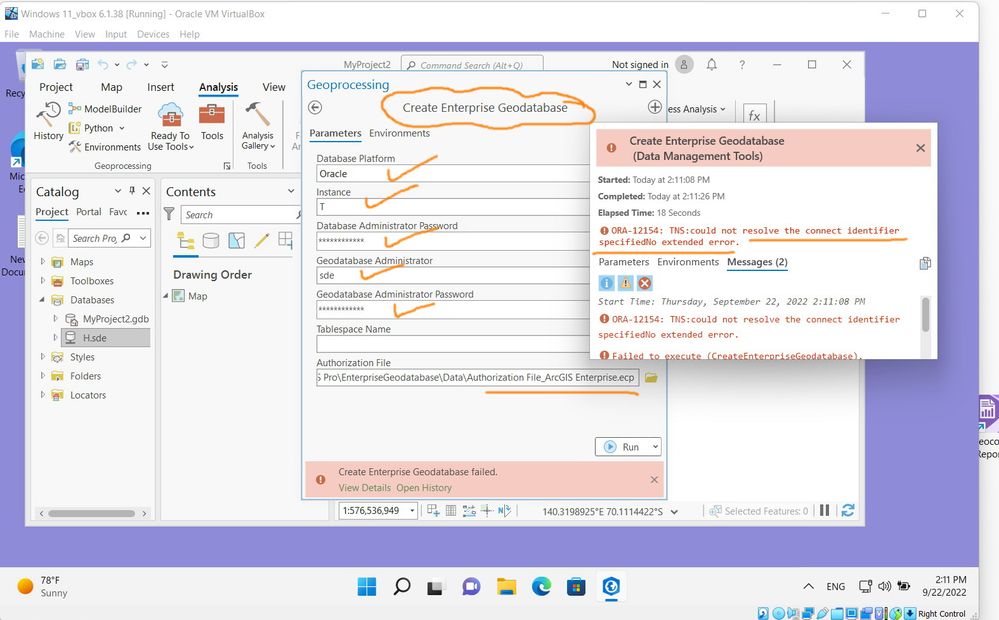

Performing the “create enterprise geodatabase” tool dnds up with the “ORA-12154: TNS: could not resolve the connect identifier specifiedNo extended error” error
What could be the issue here?

just use the EZConnect string: ServerName/SID or make sure your TNS is configured correctly.

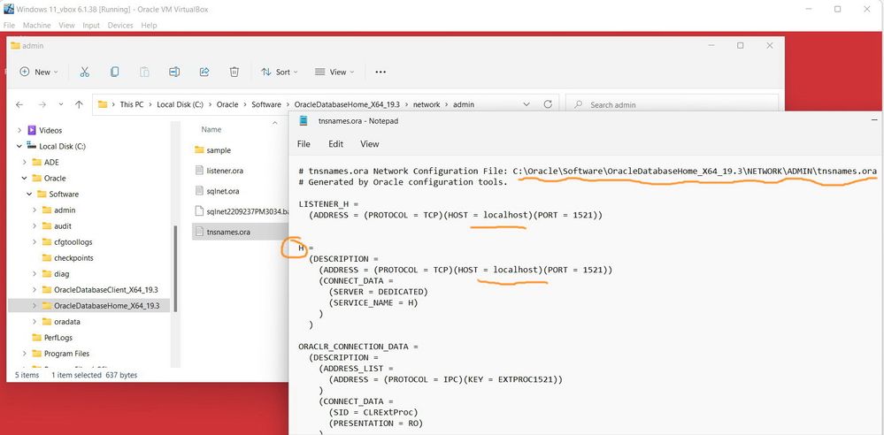

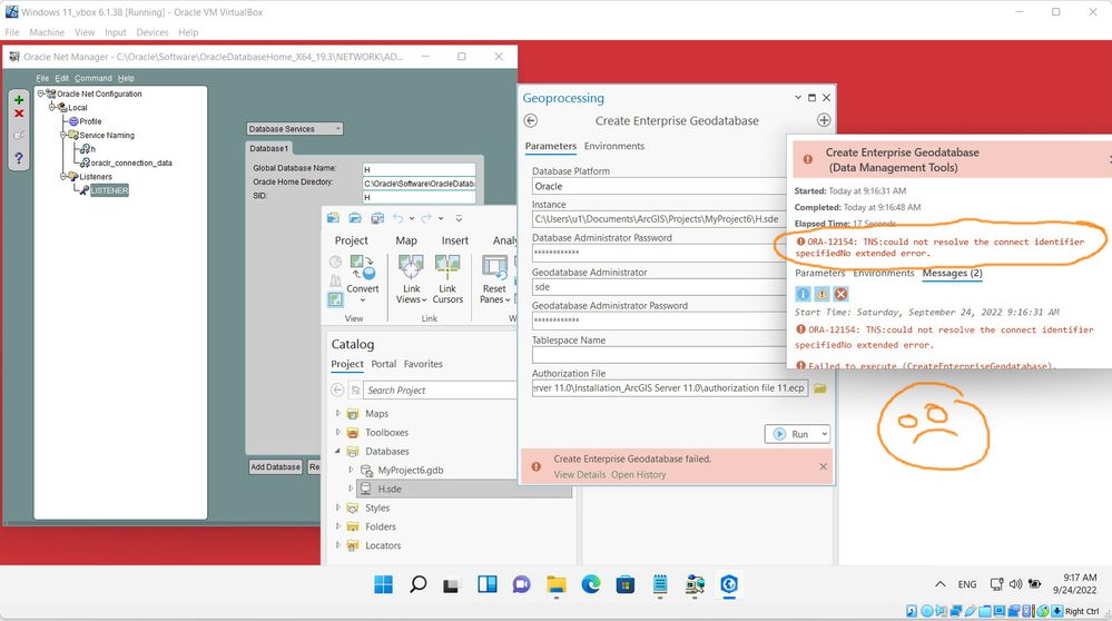

The screenshots below show the content of the listener.ora and tnsnames.ora files. The “net manager” is also configured where the oracle home director is set to be:
C:\Oracle\Software\OracleDatabaseHome_X64_19.3
Nevertheless, the “create enterprise geodatabase” tool fails
What other issues I need to check?
