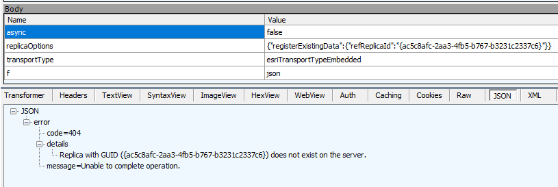

Using Fiddler, I was able to see that the “createReplica” operation was not made the same way as the old Collector:
POST to myAGSservice/FeatureServer/createReplica
I understand that the new Collector is using the replica made while creating the offline area and does not find it but it does exist in our database:

Looking at the output from the database query, I noticed that Portal for ArcGIS is registering the replica with the private url (https://hostname.company.com:6443) and Collector is trying to download it from the public Url configured with the webadaptor (https://hostalias.company.com).
If I do the very same request to “createReplica” endpoint with the same parameters but this time to the private Url (https://hostname.company.com:6443), it works.
Is it a bug or is something misconfigured with our ArcGIS Enterprise ? Any idea maybe  Jonathan Quinn‌ ?
