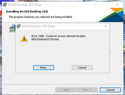

ArcGIS Desktop 10.8 setup installation error

Just a guess here, try placing the installer onto the C: drive. My guess is you are trying to run it from a network share..
