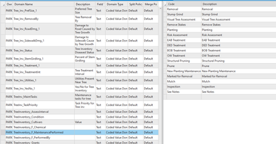

What does your domain look like?
ZachBodenner
MVP Regular Contributor
Pretty straightforward I think. This is a referenced feature service, so the domain is stored in the egdb:
Happy mapping,
- Zach
