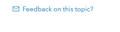

bottom right of the page where you got the into... look for
they can quickly update the online help if they are notified

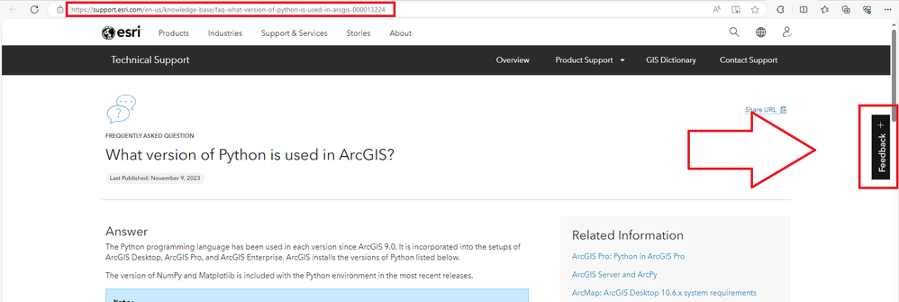

This is a tech support article so I do not see this link
MarceloMarques
https://support.esri.com/en-us/knowledge-base/faq-what-version-of-python-is-used-in-arcgis-000013224
| Marcelo Marques | Esri Principal Product Engineer | Cloud & Database Administrator | OCP - Oracle Database Certified Professional | "About: In 1992, I embarked on my journey with Esri Technology, and since 1997, I have been working with ArcSDE Geodatabases, right from its initial release. Over the past 33 years, my passion for Spatial Databases and GIS data has become a central part of my career.." | “ The mountains are calling and I must go.” – John Muir |
DougBrowning
MVP Esteemed Contributor
Thanks I was logged in as my free account so it would not show.  I used a different account and it showed up.
