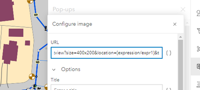

Hello, all.
I'm experimenting with adding Google Street View images to feature popups in the new map viewer in Enterprise 10.9.1. What I want to do is use an Arcade expression to build the api link using either the feature's coordinates or the address (if it has one). I can get Arcade to build the URL, but it doesn't bring anything in if I use that expression for the image URL. However, if I copy that same URL and put it in the URL box as text (rather than as from an expresssion), it works just fine. Is there a special workaround I need to get the calculated URL working properly?
JCGuarneri
Looks like I've answered my own question here: Upon inspecting what link comes out the other side where the image should be, I discovered the ampersands were getting replaced. Using URLEncode() on the whole link doesn't work, but I discovered I can just build a location string from address, street, town, and state, or from lat and long, and URLEncode() that. Then, I add the base URL as plain text to the URL box, with the expression inserted after "&location=".
