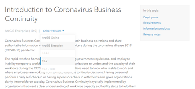

BlytheSpendlove
From looking at Esri documentation web pages (and which ones are greyed out), as well as this post, am I correct in assuming that creating hosted feature layer join views work in Enterprise 10.9 but not 10.9.1 unless the server admin url is updated to not have a "/" after arcgis?
