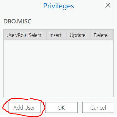

Hello,
Does somebody have a sample Python script they could share that adds users to Enterprise Geodatabase tables?  I am looking for the scripted analogy of this GUI workflow...(right click on EGDB table)
...of all or list of tables in the Enterprise Geodatabase.
Thank you,
Tyler

TylerT
Thank you, but your script is for adding users to EGDB.  My question is about assigning User privilege's to EGDB tables.  The add user dialogue in the GUI confuses the situation a bit, but I don't want to add users to EGDB, rather add users to tables in order to set to set User permissions, which is done through the dialogues shown.
For context, if a table is dropped and re-added, the User privilege's are wiped out.  We need to automate adding User privilege's back in to tables after dropping tables.
Thank you,
Tyler
