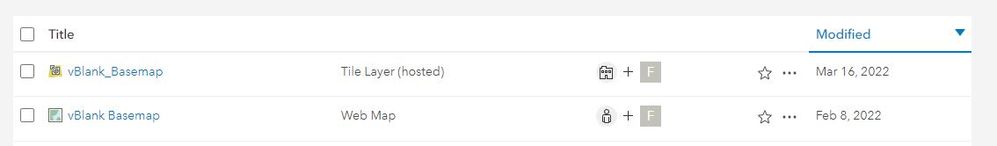

I got this to work by switching to a blank vector basemap as mentioned above.
Source here: https://www.arcgis.com/home/item.html?id=e9cacfd187904614884c16aa52a21cac

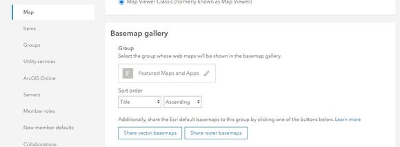

Once you get it uploaded, if you share it and create a web map with it also shared to the Featured Maps or whatever group you use as your basemap group in the Map settings in Portal Settings. Then it should show up in your basemap gallery to change your maps over to.
