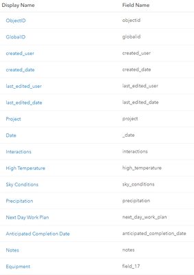

I have no idea what order it's using. It seems completely arbitrary. See below.
Note: I confirmed that the details element is pulling from the correct layer.
Default layer order:
Default Layer OrderDefault Layer Order

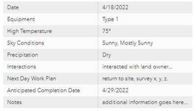

Layer popup order:
Layer Popup OrderLayer Popup Order
Map popup order:
Map Popup OrderMap Popup Order

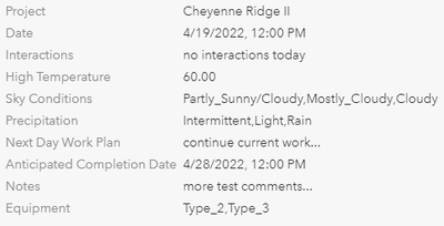

Dashboard details order:
Dashboard OrderDashboard Order

I figured out a workaround, which is to make the details pull from the layer directly instead of going through the map. It works for this project but generally this is still a problem. Either popup should be able to be used. I'm assuming this is a bug.
