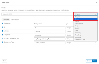

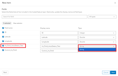

We're on Enterprise 10.9.1, so I tried my test files on AGOL and it behaved differently. AGOL would auto-assign the field to "string" regardless of the first 100 records (I didn't want to spend more time trying to figure out the magic number where auto-assigning would work on AGOL, but I figure Esri can). Oh and overriding on AGOL works, but it's not straightforward. When I tried to change the field type, the only option it would give me was "String".

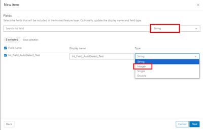

But if I set the field type display filter to "String"...
THEN it allows me to select "Integer"
Amazingly enough, the override actually worked!
