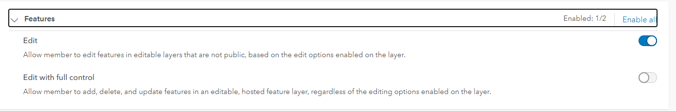

In a web app, only certain users got accces through a portal group. Some of these users (user A and B) have a editors or creator portal user type. This means they have the capability to edit features. The given member role is set up so that the user gets 'Edit' capabilities but not 'Edit with full control'.
