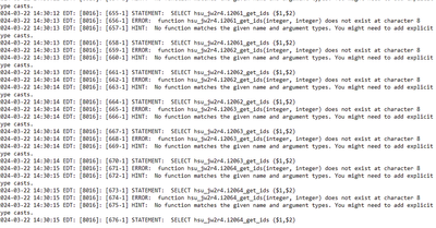

In the DataStore, we are finding unusual log messages when attempting to create a Workflow, we are seeing errors like this:

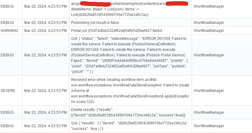

I also seem to be getting this error here:
Any ideas?

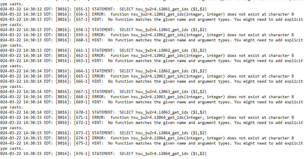

I was able to get the datastore reinstalled and rebuilt, but I'm so far unsuccessful, seeing these errors here:
Not sure what to do from here as this was the same results as previously sadly 😞

Hi @CodyPatterson, looking at your logfile more closely, it looks like you have some database corruption on the table sde.sde_spatial_references. the sde_logfile error is just chatter and can be ignored, it does look like you have different errors now. I would suggest rolling back to a backup that works but that would lead to data loss on your hosted feature services.
You can confirm this by connecting to the datastore database using pgadmin and trying to open this table if you get an error on opening it then it is probably corrupt.
I would spin up your pre upgrade backup on an isolated VM then upgrade that system again and if that succeeds copy over the backup to production if you can afford the data loss on the hosted services.

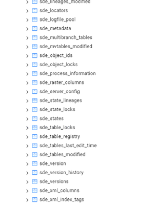

Thank you for the response, I assumed it may have been corruption as the database objects aren't correctly represented and I was seeing many issues with the indexes. A backup that would work would be 11.1 in October of 2023, I inspected some log files in that time, and as you mentioned the chatter was still there, but the database was able to select and modify the indexes without issue. 11.2 seems to be the major issue.
An edit as well: The tables do not exist at all in the pgAdmin view, sde_spatial_references and sde_logfile are missing, many of the indexes are missing as well.
