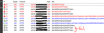

More info... got fiddler running during the exchange... see pic below...
  • Runs a few requests against the various 'portal/info' endpoints, most fail, but then the 'sharing' one works.
  • Then does the OAUTH sequence which successfully generates an access token
  • Then it attaches the access token as auth header Bearer xxxxxxx on the final two info requests (which are fine without any auth) and those get the 403 result.
