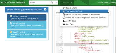

Using the ArcGIS Online Assistant or Python, you can access the SQL statement reflected in the filter settings, and adjust it however you like. The string is stored in the Web Map's JSON as the "definitionExpression" property.
    "operationalLayers": [
            "id": "Sales_Hosted_2910",
            "layerType": "ArcGISFeatureLayer",
            "url": "https://services6.arcgis.com/U1zX3Wx8hhY7Gb30/arcgis/rest/services/Sales_Hosted/FeatureServer/0",
            "visibility": true,
            "opacity": 1,
            "title": "Sales_Hosted",
            "itemId": "a405b06ae8e24f94a2768a4581b79e73",
            "layerDefinition": {
                "definitionExpression": "valid_sale = 1",
- Josh Carlson

Thanks.  I didn't even think of that. We have used the assistant quite often when moving thins from AGO to Portal.  I will give that a shot.

If it were me - I would mark this as solved because this suggestion totally works.  This was really helpful for adding a fairly large, nested query that I built using Pro.  Thanks a bunch Josh.
