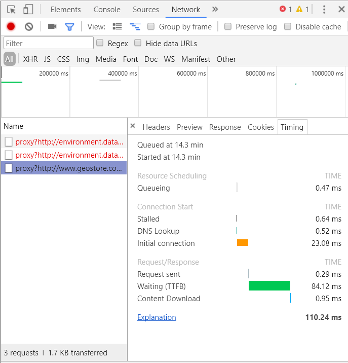

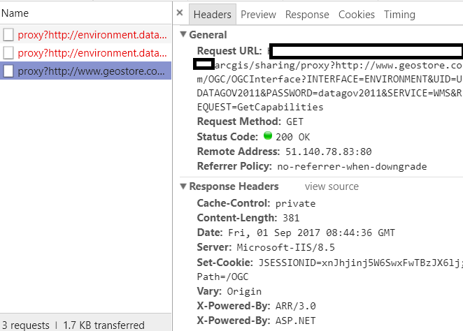

We use HTTPS by default, but I opened the web map viewer in HTTP and still received the same error.  I am not too familiar with the Dev tools in Chrome, but noticed that I was getting the following warnings.  I am unable to add this particular feed to AGOL together either so there may be something going on with their Server?
However, I was able to add this wms feed to AGOL and not our Portal (over HTTP web map) and received the same error message and the following:

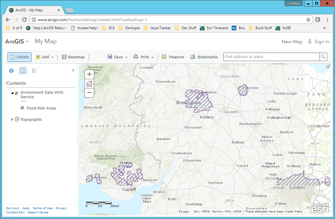

I was able to get the WMS service working in AGOL:
In regards to the errors in your Portal, when you see a request go through the sharing proxy, (https://<machine>.<domain>.com/arcgis/sharing/proxy?<url>), that means the request is actually being made from the Portal machine itself.  Does your Portal machine have access to that resource?  An easy way to test this is to sign onto the machine as the user running the Portal Windows service or the install user on Linux and try to reach the WMS URL in a browser.  If you can't as that user, then you'll need to speak with your IT staff about allowing outbound access to external resources.
