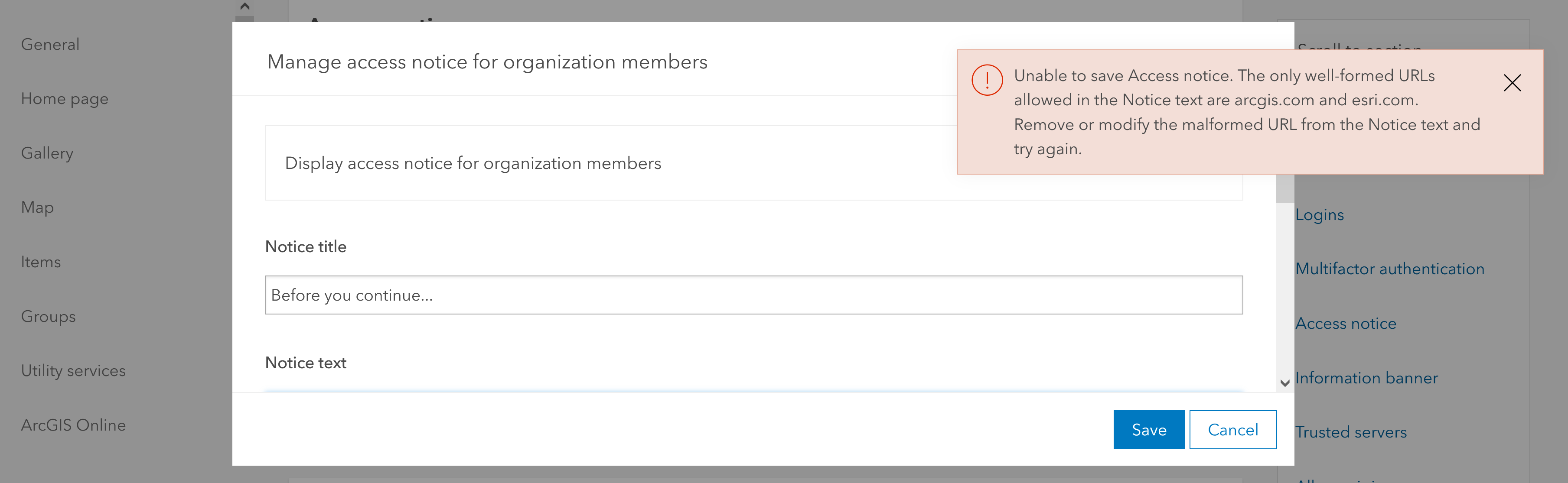

We have a ArcGIS Enterprise Base Deployment in-house. Why can't I add another URL other than arcgis.com and esri.com?
I can't even add an URL in plain text. This does not make sense at all and is mildly said absurd and unusable.
How can I add a link pointing to an internal server?

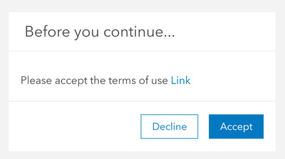

If I add a HTML tag like this:
<a href="https://gis.servername.com" target="_blank">Link<a>
There won't be an error but it replace the tag with this:
<a href='' rel='nofollow ugc' target=''>Link</a>

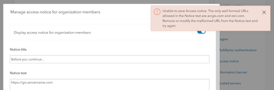

If I add https://gis.servername.com without a HTML tag, then I get the error shown in my question.
