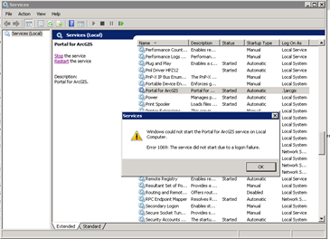

I need urgent help please! I am in the process of upgrading from Portal for ArcGIS 10.3.1 to 10.4 and I'm stuck. I have successfully upgrade (to 10.4) all other associated applications such as, ArcGIS Desktop, ArcGIS License Manager and ArcGIS for Server. Next on my list was Portal for ArcGIS, then the Web Adaptor last.
I thought the Portal for ArcGIS Account was the Initial Administrator Account or the existing Portal's Login detail. Tried both and I got the error seen below. Where am I going wrong? What is the Portal for ArcGIS Account?

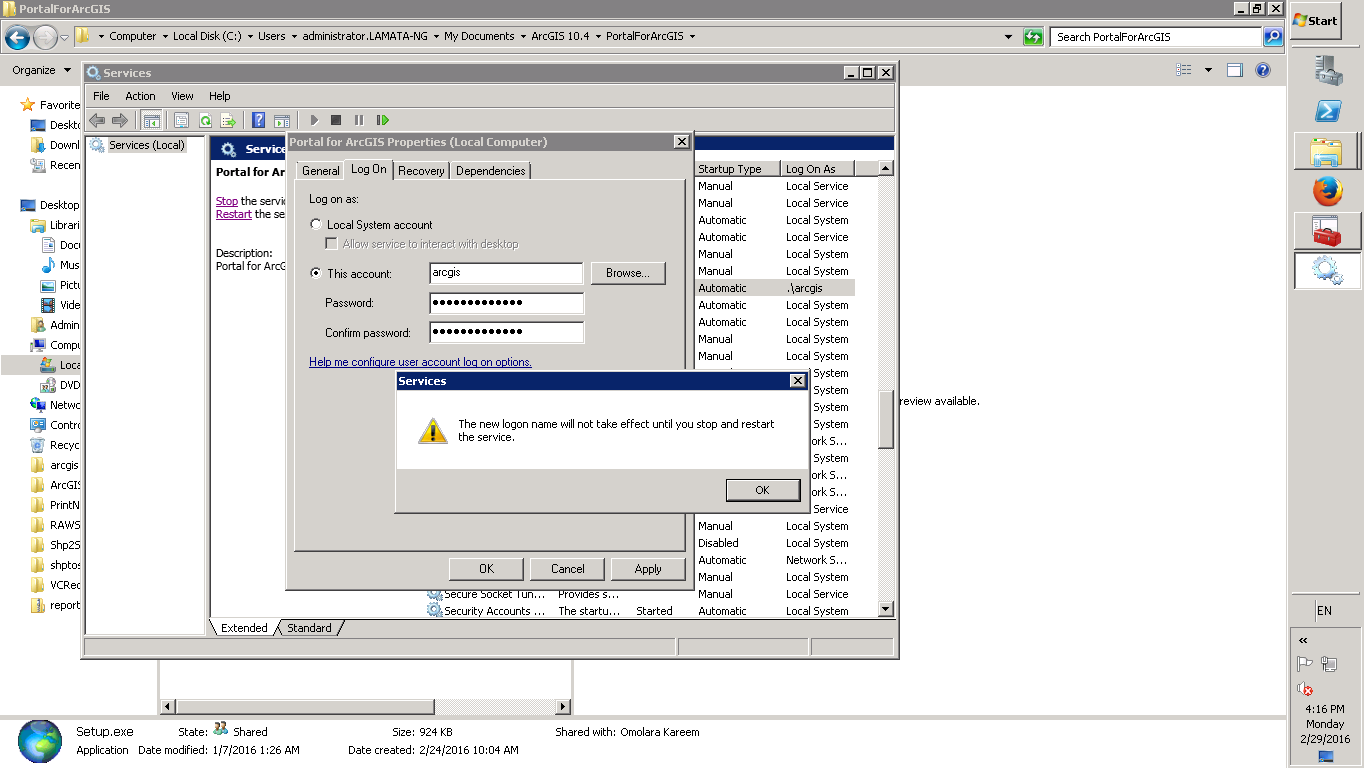

Try setting the password of your ArcGIS Server Account user within the Computer Management dialog:
Then see if you get the 'invalid password' when you are specifying the Portal for ArcGIS account using the ArcGIS Server Account.
OmolaraKareem
It worked!!!! Thanks Jake, that did the trick!

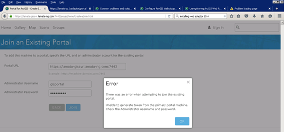

I've installed Portal for ArcGIS 10.4 successfully, now I have other problems. Really sorry to be a bother, but I hope you can help me again.Here goes;
1. Directed to this page after installation:
Have no plans to create a new portal. Selected Join Existing Portal (Portal for ArcGIS 10.3.1 was up and running before 10.4 install.)
Put in all the particulars. Got the error below.

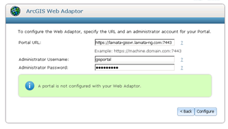

2. Tried to install the webadaptor. Another snag!
Below is what the error log had to say.
Help please! My Portal can't be down for long. My users will go up in arms.

"The location you specify must be a local directory; you cannot choose a shared network directory. This is because the Portal for ArcGIS service is configured to run under the Windows native LocalSystem account by default. The LocalSystem account cannot access network locations. After installation, it is possible to change the account that is used to run Portal for ArcGIS."
I never changed the account. Have tried to do so now. No deal!
2. It now looks to me that 10.4 wants installation to be on a Local or Domain Account.
How do I make this transition? I have tried everything I can think of.

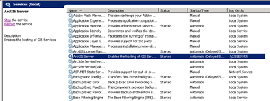

Here is my ArcGIS Server Service, if it is of any relevance.
Help!
