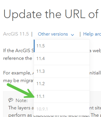

Do you know when ESRI added this capability, enterprise version?
George_Thompson
Esri Notable Contributor
Looks like 11.1 was the earliest, but I would verify the help doc page for any specifics based on the version you are using:
