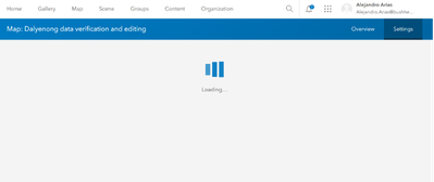

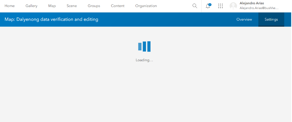

The Settings page of many existing web maps on the spatial portal has become inaccessible. This are the settings inside the item (next to "Overview"). When attempting to access the settings page via the portal user interface or the URL, it gets stuck on the load screen:

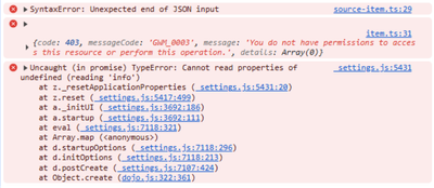

  • Inspected Chrome dev tools console and displays 3 errors: daarias331_1-1759966822976.pngdaarias331_1-1759966822976.png
    The first 2 errors (syntaxError and “code:403”) occur after opening the item in the portal. The last error (“Uncaught (in promise) TypeError) occurs after trying to open the Settings of the item

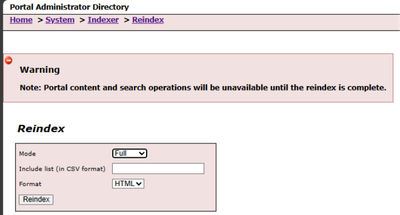

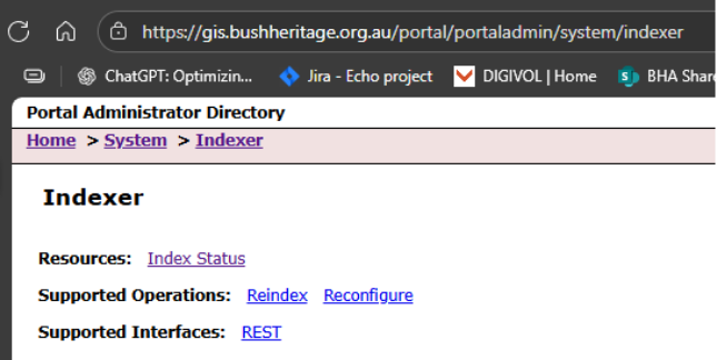

Tried reindexing the portal (Full)daarias331_2-1759967015724.pngdaarias331_2-1759967015724.pngdaarias331_4-1759967034882.pngdaarias331_4-1759967034882.png

There is still the weird "Unexpected end of JSON " along the 403 error message when we open the item
Later, following the advice of the main solution here Solved: Manage Offline Areas button grayed out on map sett... - Esri Community, I unshared the item from a group designed to give access to external contractors
This  got rid of the "Unexpected end of JSON input" and the 403 error message.
