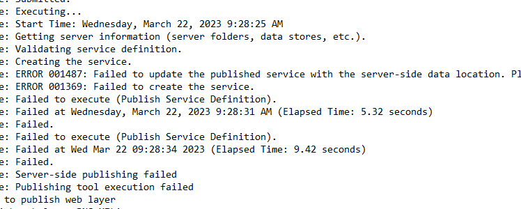

I haven't been able to publish to portal for months now. I can successfully publish from file geodatabases, and I can copy from my sql database, but cannot publish referenced data from the sql database. I know this was possible in the past.
I've upgraded by database, I am using my editor login to the database with portaladmin login. My databases validate before I publish and then I get the error when trying to publish, go back to validate and they are no longer validated.

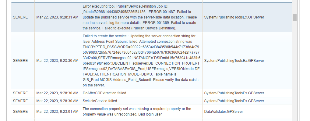

The datastore does validate and I haven't had issues there. It has to do with the sde connections
RaymondHuang_Sg
It seems the existing SDE connection string is no longer valid. This could be due activities such as password change to the account that was used to create that SDE connection file, or other less likely activities such as changes to port accessibility on the EGDB, or the privileges of the user mcgis. In any case, you may consider the approach of creating a new SDE file using the existing credentials via the Create Database Connection (Data Management) tool to verify if the credentials are still valid. Let us know?
