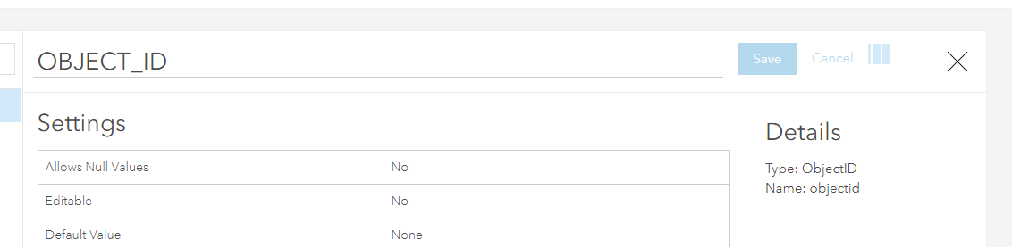

In the example below, I am trying to change the attribute name from OBJECTID to OBJECT_ID and I can edit it but when I press save, nothing happens. I get the same result, regardless of the field name.

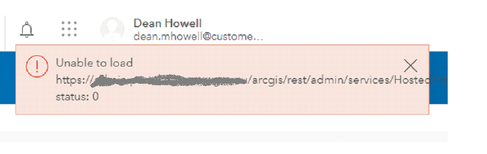

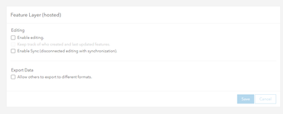

I tried to update the layer edit settings

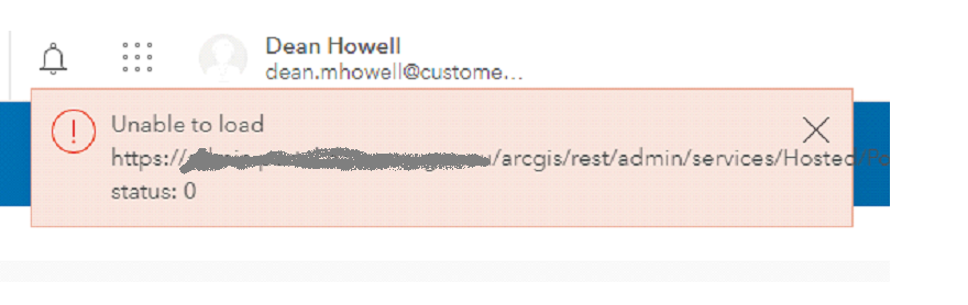

But get the following error.

Hello @JayantaPoddar , yes sorry I was not more specific, it is the alias I am trying to change but not able to do it. I can edit the data and display the data fine just can't change the field alias.

Thanks @JayantaPoddar, it is looking more like a federation issue at present as portal is trying to access the wrong site for admin type functions.
