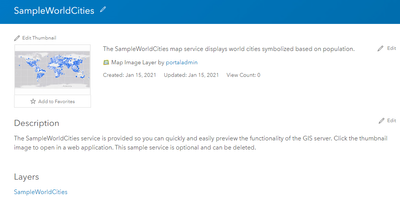

When you open up a service in Portal do you see the Layers heading if this does not appear then it is a indication that portal can not communicate with the service.

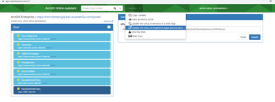

If this is the case then inspect the url you do this with a tool called ago-assistant
Login navigate to the service and under "I want to" select Update the URLs of Registered Apps and Services, this will then display the URL on the right.
Does the displayed url match the url you are accessing in the rest? if not you can just update it with the correct url and that should fix the problem.

Thank you for your suggestion of looking at the service URL for the Portal items. I thought I had already done that, but when I looked again, it appears that an additional "rest" had been added in the URL somehow. I can only assume this has to do with the way that I configured Portal to communicate with Server, but I will go through and fix the URLs. Thanks again!
