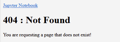

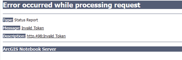

Recently, I've been getting this when starting a new Notebook, it will happen for all users:
If I press Jupyter Notebook, I get this:
Any way to change the token to the correct one? Just looking to change the token itself, maybe there's a config file somewhere? I've found some tokens before but haven't been able to find if they're the right ones!

I was able to get most of the Notebook issues resolved by changing a WebContextURL on the Notebook server itself. If you have a reverse proxy or are redirecting the traffic in any way, it seems to be the solution if we change the URL. Example:
Portal is https://arcgis.reverse-proxy.com/portal
Notebook was https://arcgis.notebook.local/notebook
Changed to https://arcgis.reverse-proxy/notebook
That had seemingly fixed the issue, now we are at a point where it immediately fails connecting to the kernel, so we're reaching out to professional services to get this checked out, I also have a ticket open, so I can let you know what happens!
